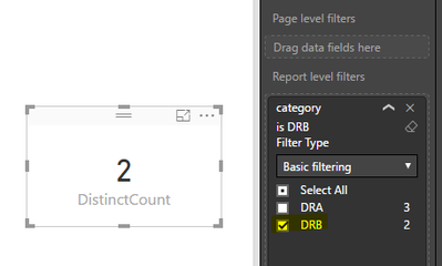

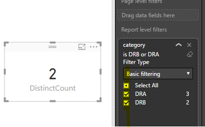

Yeah, ALL function ignores any filters that might have been applied. I create the following sample table.
Create measure use the formual:
DistinctCount = CALCULATE(DISTINCTCOUNT(Table1[physicians]),ALL(Table1[category]))
Add the Table1[category] as report level filter. Create a card visual, it display the measure value. Whenever I select any value in the page level, the measure value is constant 2.

Hi @ttrandai,
When I add Table1[physicians] as report level filter, I create the following formula. It still return 4 whenever you select any value.
DistinctCount = CALCULATE(DISTINCTCOUNT(Table1[physicians]),ALL(Table1[physicians]))
For you requriement, you need to create the formula.
result=CALCULATE( DISTINCTCOUNT( Table[Fiscal Half] ),all( [Fiscal Half] ) )
