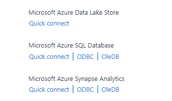

I've tried connecting via "Microsoft Azure Data Lake Store" and "Microsoft Azure Synapse Analytics" and have been unsuccesful with both.  My understanding is that Data Lake would be read-only, but that in theory I should be able to read/write to a Data Warehouse artifact via Alteryx.

Now try the actual option - Microsoft Azure SQL Database.
Unfortunately I have not been able to get this option to work either.
