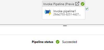

One thing to watch out for here is permissions - while your business users don't need access to the original workspace, they do at the very least need to have access to a Fabric Data Pipelines cloud connection that uses credentials that do have contributor access or above on the original workspace. This can result in some... interesting quirks in the pipelines UI for your business users - if they don't have access to the original workspace at all, they will see errors on the Invoke Pipeline activity about the workspace and pipeline not existing, but still be able to run it (the activity displays a GUID):
The workspace list displayed uses the user's credentials, and not the credentials for the selected connection. This means users won't be able to develop their own pipelines invoking yours, but doesn't stop them from running this apparently broken activity if you create it for them:
If you do need to enable your users to create their own Invoke Pipeline activity, you can grant them viewer access on the original workspace (the Invoke Pipeline activity now displays the pipeline name rather than GUID). If you do this, when they go to execute it, they may get a message saying they don't have access to all the connections in the pipeline if there are those downstream in your pipeline that hasn't been shared with them. Despite this, it still appears to have no problems executing (I've tested the below where the original pipeline uses a connection that the 'business user' doesn't have access):
