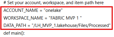

# Set your account, workspace, and item path here
ACCOUNT_NAME = "onelake"
WORKSPACE_NAME = "FABRIC MVP 1 "
DATA_PATH = "/LH_MVP_1.lakehouse/Files/Processed"

  • Hello,
    I have found the cause of it, and it has to do with the nomenclature you follow for naming your lakehouse, workspace and all subsequent objects. They should not have upper case letters or special characters. That solved the problem for us!

    The error message "azure.core.exceptions.ResourceNotFoundError:Artifact'lakehouse' is not found in workspace 'MVP'
    ErrorCode:ArtifactNotFound" indicates that the Lakehouse project cannot be found in the specified workspace.
    Please check the following aspects:
    • Double-check the names of your workspace and Lakehouse. Make sure there are no typos or extra spaces.
    • Verify that the Lakehouse project actually exists in the specified workspace. It is possible that lakehouse is in another workspace.
    If you have any other questions please feel free to contact me.

      Hi Yang,
      I had updated the code posted here with different names to maintain integrity of the organization.
      I have validated the names for any typos or additional space, but thats not the case.
      Copying workspace name from the portal and ensuring to copy name of lakehouse as is has been my approach. So there is no chance of such misses.

      Do you know if the format in which the data path is passed is correct here "file_system_client.get_paths(path=DATA_PATH)"?
