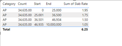

Hi i am tring to pull slab based factor from my data
i have total count of 34,635 in one table and slabs on another table now i have to lookup slab rate which is 1.75 based on count of 34,635 which falls under 25001 - 36500.
count will increase every month and every time it should lookup the factor based on total counts
Count Table
Slab rate table

For your question, here is the method I provided:
Here's some dummy data
“Count Table”
“Slab rate Table”
Create a measure.
Measure slabs =
var _Category = SELECTEDVALUE('Count Table'[Category])
var _count = SELECTEDVALUE('Count Table'[Count])
CALCULATE(
SELECTEDVALUE('Slab rate Table'[Slab Rate]),
FILTER(
ALL('Slab rate Table'),
'Slab rate Table'[Category] = _Category
'Slab rate Table'[Start] <= _count
'Slab rate Table'[End] >= _count
Or create a column.
Column slabs =
CALCULATE(
FILTER(
'Slab rate Table'[Category] = 'Count Table'[Category]
'Slab rate Table'[Start] <= 'Count Table'[Count]
'Slab rate Table'[End] >= 'Count Table'[Count]
Here is the result.
