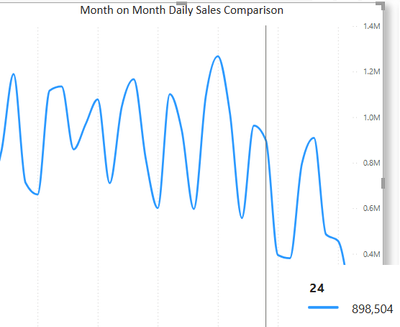

Hi, thanks for your reply, unfortuanley this  doesnt sum the sales as the month goes on this just shows what the sales where on each day, what i want to see are the sales growing daily until we see the final sales figure at the end of the month, I also need both years showng without the need for a slicer in the way that this chart does, hope you can help?
