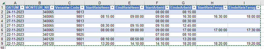

I have a table with different times for different technicians each day. I would like to calculate the total worked time per day per technician, per week, per month, and per year. What is the correct DAX formula for this? I already have several calculations. The total time per day per technician seems to be correct. However, when I try to display this in a matrix table per week or per month, it doesn't sum up the times. It keeps looking at the first time and the last time per period. Who has a suitable solution?
Example:

  • Totale tijd min = CALCULATE(DATEDIFF([Min Time],[Max Time],MINUTE)) //
  • Totale tijd uur = [Totale tijd min]/60
Then the ‘Totale tijd min’ provides the total working time in minutes per day. When I place this as a value in a matrix table, I get an incorrect calculation of the total time. Also, when I try to see the total working time per week, I do not get accurate results.
