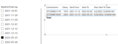

Hi @aatish178 ,
First of all, many thanks to @lbendlin for your very quick and effective replies.
Based on my testing, please try the following methods again:
1.Create the simple tables.
2.Create the new measure to filter the Valid to date and max of date.
Max Valid To Date =
VAR sel_date = SELECTEDVALUE(Table1[DateForFiltering])
var t2_date = SELECTEDVALUE(Table2[Valid To])
VAR result = CALCULATE(MAX(Table2[Valid To]), FILTER(ALLEXCEPT(Table2, Table2[Combination]), Table2[Valid To] <= sel_date && Table2[Valid From] <= sel_date))
IF(t2_date = result,result,BLANK())
3.Drag the Table1 date field into the slicer visual.
4.Select the 2022-05-25. The result is shown below.
Wisdom Wu
