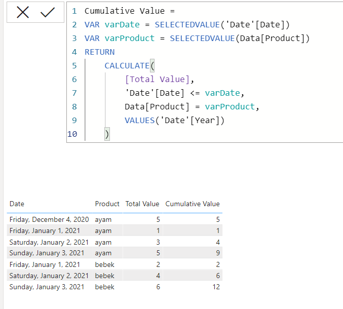

This is actually very easy to do if you have a Date table. The predicate for Data[Date] removes the filter for the date.
VALUES(Date[Year]) puts it back. So you see how I modified the data to have some 2020 data for Ayam, but it resets Jan 1 for the running total. You'll also notice I replaced the Data[Date] field in the measure with 'Date'[Date] - again, using the DIM Date table.
Cumulative Value =
VAR varDate = SELECTEDVALUE('Date'[Date])
VAR varProduct = SELECTEDVALUE(Data[Product])
    CALCULATE(
        [Total Value],
        'Date'[Date] <= varDate,
        Data[Product] = varProduct,
        VALUES('Date'[Year])
My table is out of sort order but it doesn't matter. You can sort by date and it still works.

Now, Name that Date, then when back in DAX, right-click and Mark as Date Table, selecting the Date column.
Finally, set your model to look like this. You'll notice I hid the Date in the data table. You want to use the Date from your Date table - best practice.
I am 100% sure this can be done without a date table, but I am also 100% sure your DAX will be more complex, as you are discovering. Using a proper Star Schema with Dimension and Fact tables (Date is a dimension, your sales data or whatever it is is the FACT table) makes the DAX much easier.
