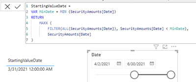

FreemanZ
A measure with the code below shall work:
StartingValueDate =
VAR MinDate = MIN (SecurityAmounts[Date])
    MAXX (
        FILTER(ALL(SecurityAmounts[Date]), SecurityAmounts[Date] < MinDate),

FreemanZ
StartingValueDate =
    MAXX (
