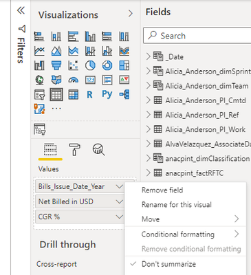

@Joseph_Hchaime , that's odd. What items do you have in the Values section of your Table visual? This is what I have:

@Joseph_Hchaime , ok, make therse changes:
Create a Calculated Column in Power BI for your table VW_Bills_Table
Bills_Issue_Date_Year = YEAR(VW_Bills_Table[Bills_Issue_Date])
 Add the Bills_Issue_Date_Year column to the Values section of your Table visual, and make sure to set the column to Don't Summarize
Change the measure [CGR %] to use the new column Bills_Issue_date_Year
CGR % =
VAR vThisYear = SELECTEDVALUE('VW_Bills_Table'[Bills_Issue_Date_Year])
VAR vLastYear = vThisYear - 1
VAR vCCRThisYear =
    CALCULATE(
        [Net Billed in USD],
        ALL('VW_Bills_Table'),
        'VW_Bills_Table'[Bills_Issue_Date_Year] = vThisYear
VAR vCCRLastYear =
    CALCULATE(
        'VW_Bills_Table'[Bills_Issue_Date_Year] = vLastYear
VAR vCGR = DIVIDE((vCCRThisYear - vCCRLastYear), vCCRLastYear)
RETURN vCGR
That should do it.
