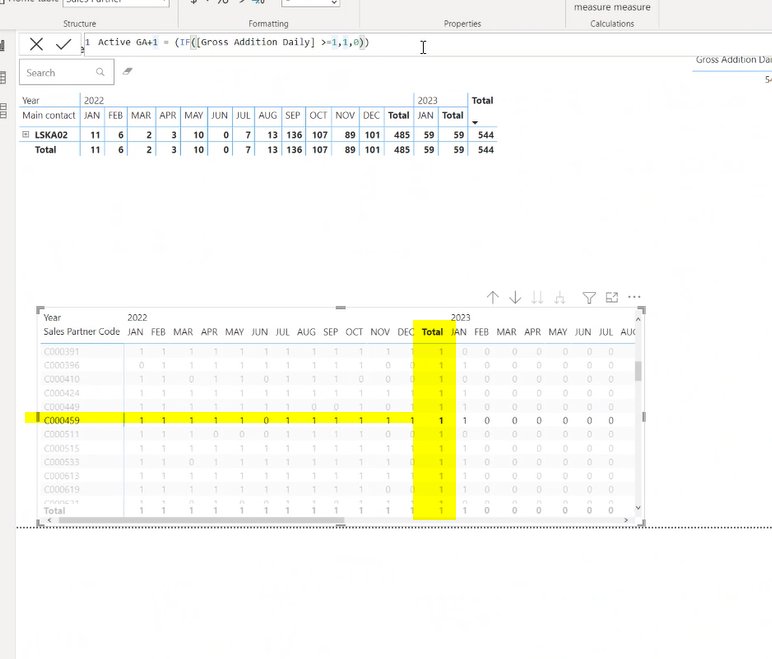

True/false measure not giving total
What do I need to do to have a correct total on the highlighted table? It should be 7.
Thanks!
johnt75
You need to add up the individual values, not compute the whole thing at the aggregate level. Try
Active GA+1 =
SUMX (
    VALUES ( 'Table'[Sales partner code] ),
    IF ( [Gross Addition Daily] >= 1, 1, 0 )
where 'Table'[Sales partner code] is the column you are grouping by in the matrix

ROG
Responsive Resident
Responsive Resident
Thank you @johnt75
