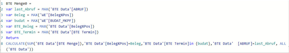

the above shown code is my dax measure. This measures produces values for the respective BelegXPos when I use it in a table but doesn't show the grand total in the table and also shows up a blank when I use it in a 'Card' visual. Do you guys have any idea why could it be so..? Sample dataset is given below. Thanks a lot in advance.

thanks for your reply. It didn't work. So I duplciated the tables and worked it out through 'Group by' function in Power Query.

Maybe you just need to add a SUMX
BTE Menge1=
SUMX('Table',[BTE Menge0])
//or use SUMX (VALUES(Table[DAT]),[BTE Menge0]) if you try to sum by date
@mlsx4 thanks for your reply. I did try working with SUMX function and its giving me a result and not blank.... the problem now is that I'm comparing 3 scenarios like the following:
1st scenario: where BTE_Termin = budat
2nd scenario: where BTE_Termin - budat <=1, for which I'm using the following code:
3rd scenario: where BTE_Termin - budat <= 2, for which the following code is being used:
but SUMX seems to give me the same answer for all 3 scenarios. instead the BTE MengeX (result column in red: see table in 1st question) should be different for different scenarios. the measures are giving me different BTE Menge in table visual but not in a card or chart.
hope you can understand the issue. thanks!
Hi @Commons94
Yes, I understand the issue. And if you add a condition? Something similar to:
If (selectedvalue(BelegX)="", menge0+menge1+menge2)
