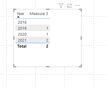

    Hi janislv ,
    I tested your measure and I find that it will return the YTD sum of [Measure] after 03/31 by  in last year. If you want to do the same with Hourly , I think time intelligence functions don't support you to do this. Try this code.
    Here I want to get YTD sum of values after 06/01 8:00:00.
    My sample:
    Measure:
    Measure 3 =
    VAR _ADD1 = ADDCOLUMNS(ALL('Table'),"Year",YEAR('Table'[Date]),"Month",MONTH('Table'[Date]),"Day",DAY('Table'[Date]),"Hour",HOUR('Table'[Date]))
    VAR _ADD2 = SUMMARIZE(_ADD1,[Year],"Sum", SUMX(FILTER(_ADD1,[Year]=EARLIER([Year])&&[Month]>=6&&[Day]>=1&&[Hour]>8),[Value]))
    Return
    SUMX(FILTER(_ADD2,[Year] = MAX('Daily calendar'[Year])-1),[Sum])
    Result is as below.

    Hi janislv ,
    My sample:
    Measure:
    Measure 3 =
    Return
    Result is as below.
    Rico Zhou
