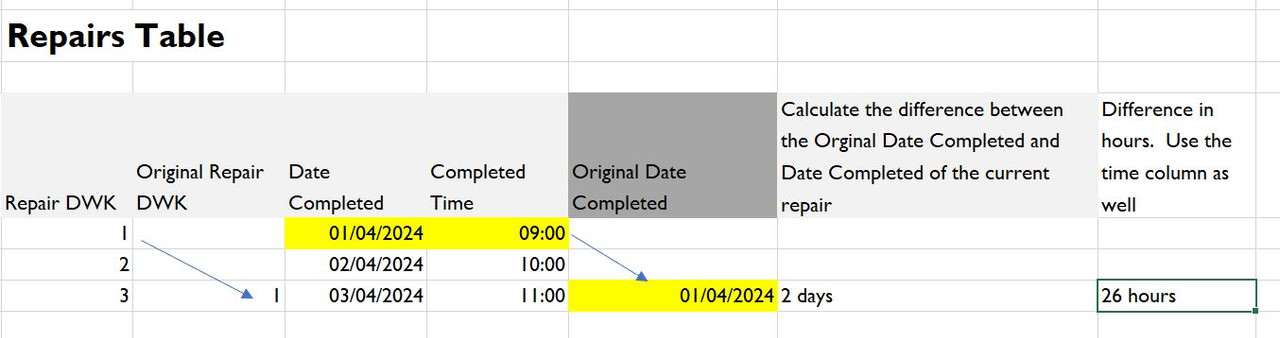

Below is an image trying to illustrate what I am trying to achieve.
https://i.postimg.cc/zDPdgc4t/Repairs.jpg
I have a 'Repairs' table.  A repair may have an original repair.  I need a DAX measure to calculate the difference in hours between the date/time completed of the original repair (if there was one) and the new repair completed date/time.
I am pretty new to DAX and can't wrap my head around how to do this but I would be really grateful if you could point me in the right direction.

lbendlin
    Source = Table.FromRows(Json.Document(Binary.Decompress(Binary.FromText("jZJbjoNADASvssp32NhuP+cqUe5/jTUiKCECsnwxI6gpd8/9fpmM1SsE6lSiQf1crr0tioAhFGqZz22yG+lNSLQXnFUTywT6YRrAIPqdP3tc7xdumjFKyix6sfw+E+SAoMP4nXBgcIawwbJBKDgAKFIatiKmfgvj9Ehy91gm08PJdAttXqQQGTkx6AndH/iMGpu8wgpcGaa2DDuLMiQiq4tJVOp6VB5AuwFsVc28hKlU2XOVmtRCJdU5uJzpS7dUgz4S2MnvrBeMruYd4K0TbSEOB9urWj5C+GcL+9GcWcTHFZ3UTbMR4TD9rwVtEbtJzhY4QPCQ1zV//AE=", BinaryEncoding.Base64), Compression.Deflate)), let _t = ((type nullable text) meta [Serialized.Text = true]) in type table [#"Repair DWK" = _t, #"Original Repair DWK" = _t, #"Date Completed" = _t, #"Completed Time" = _t]),
    #"Changed Type" = Table.TransformColumnTypes(Source,{ {"Completed Time", type datetime}}),
    #"Changed Type1" = Table.TransformColumnTypes(#"Changed Type",{{"Completed Time", type time}, {"Date Completed", type date}},"en-GB"),
    #"Merged Queries" = Table.NestedJoin(#"Changed Type1", {"Original Repair DWK"}, #"Changed Type1", {"Repair DWK"}, "Changed Type1", JoinKind.LeftOuter),
    #"Expanded Changed Type1" = Table.ExpandTableColumn(#"Merged Queries", "Changed Type1", {"Date Completed", "Completed Time"}, {"Orig Date Completed", "Orig Completed Time"}),
    #"Added Custom" = Table.AddColumn(#"Expanded Changed Type1", "Hour Difference", each 24 * ( Number.From([Date Completed]&[Completed Time])-Number.From([Orig Date Completed]&[Orig Completed Time])),type number)
    #"Added Custom"
How to use this code: Create a new Blank Query. Click on "Advanced Editor". Replace the code in the window with the code provided here. Click "Done". Once you examined the code, replace the Source step with your own source.

Alex87
Solution Sage
Solution Sage
Hello!
Here is a pattern that you can use to calculate the difference in hours between two date/time columns
Duration Diff (hours) =
CALCULATE(
    DATEDIFF(
        MIN(Hours[Date Completed]),
        MIN(Hours[Follow Up Time Completed]),
        HOUR),
    Hours[Original Repair DWK] <> "-888")
If it helps, please mark my reply as the solution
Best regads,
Alex
Appreciate your Like/Kudos
BirdyM
Thanks for your reply.  That will calculate the difference between two dates but the harder part is actually getting the orginal repair completion date which unfornuately that DAX doesn't do
