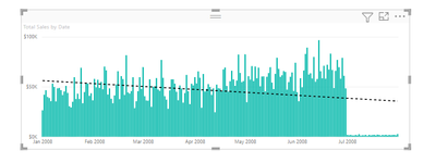

I had a little luck changing the chart type to Line & Clustered Column and using DATE in Axis. Then you get a trend line. There are perhaps more ways but this got closer to what you'd like.

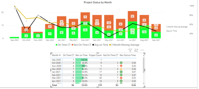

Maybe you will like moving average. Here is a 3-mnoth and it smooths the average out and is a trend lagging indicator. the link from before should have it.
Hello: I did my best with the data available. I made two sets for percent and number of projects compeleted and you can swop out. I did not find trend on stacked column but created average monthly measure to substitute. I hope this helps!

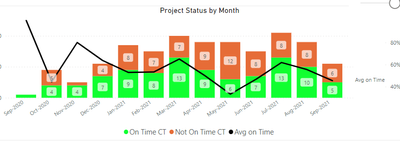

I will include some of the data below. I basically want it to look just like what I have but a line to emphasize a trend line. Image below to give an idea. So I imagine I will need to use the line and stacked visual but I cannot get it to show in % for that month. My formula is in the original post. It is a calculated column. for the visual below Green = "yes" and red = "no". I appreciate you taking the time to help me. This seems like an easy fix so its driving me crazy.
This is exactly what I was looking for. Thank you so much Bill!
