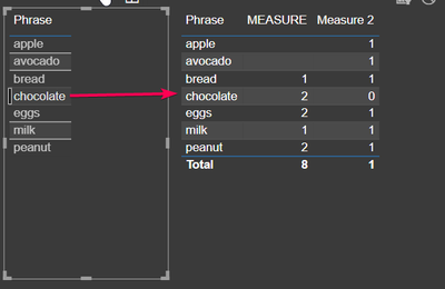

Thank you for your further explanation. Now in understand it.
You have to create a second table for the slicer.
And create a measure:
Measure =
VAR _selectphrase = SELECTEDVALUE(Dim[Phrase])
VAR _id= SUMMARIZE(FILTER(ALLSELECTED('Fact'),'Fact'[Phrase]=_selectphrase),'Fact'[ID])
RETURN CALCULATE(count('Fact'[Phrase]),FILTER('Fact','Fact'[ID] IN _id))
The result: the phrase column is from the fact table!

You can also filter out "peanut" this will be second measure for the filter plane of the matrix.

To show the result of the measure:
You do not have to use this Measure 2 in the matrix. It is only for the visualization of the result.
This is brilliant - thank you so much! Exactly (almost! what I needed...). Thanks as well for the screen shots, the one showing that the two tables do NOT have a relationship is key... One issue is the second measure. Using the data we've been using... if I pick Chocolate the measures are exactly what I'd expect...
but when I apply Measure2 to be greater than or equal to 1, Chocolate is removed but so are all the other counts... I think it's because my selected value search term is gone... the reason I care is that if I can show the counts for all BUT the search term I can show the percent of the column as well as the counts which I think may be useful.
Can you please check from which table is the slicer(should be dim!) and from which table is the column in the matrix(should be fact!) Also post your measure 2 definition please.
Mark my post as solution if it was helpfull, thanks 🙂
Definately DIM and FACT as directed
Measure 2 =
VAR _select = SELECTEDVALUE(Dim[Phrase])
if(SELECTEDVALUE('Fact'[Phrase])<>_select,1,0)
