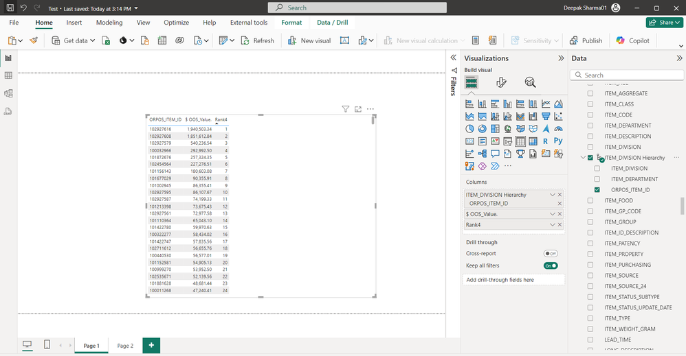

Hi all,
I have written a DAX to rank a measure, which I'll use with different columns but the result is Orpos_item_ID is working fine but with other columns from the same table it is not working.
Rank4 =
RANKX(
    ALLSELECTED('Item category'),
    CALCULATE(
        [$ OOS_Value.],
        'Item category'[ITEM_TYPE] IN { "Regular", "Hold PO" },
        'Item category'[ITEM_PURCHASING] = "Regular"
    DESC,Dense

Hi @shafiz_p ,
I've written below metioned DAX, It is working fine on indivisual selections but when I'm selecting multiple columns then it is not working.

Hi @shafiz_p ,
I want to achieve this in a table,
On single selection
On Multiple selections
