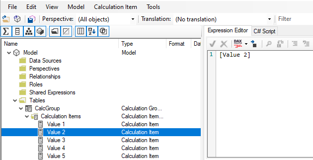

I'm attaching a pbix where I've implemented this as described in the above articles along with a slightly simpler method that works as follows:
Define a new Calculation Group with each calculation item Value 1 = [Value 1], Value 2 = [Value 2], etc.
^^ Tabular Editor 2 ^^
You can drag them around to sort the order and it automatically creates an ordinal column for sorting. That starts at 0 though, so you can define a calculated column on the CalcGroup table as CalcGroup[Ordinal] + 1.
Now define the measure to replace your switching measure as
CALCULATE ( [DummyMeasure], CalcGroup )
It doesn't matter what measure you put in the first argument because it gets replaced when you use CalcGroup as filter context.
Now use the CalcGroup index and this new measure in your waterfall chart.
