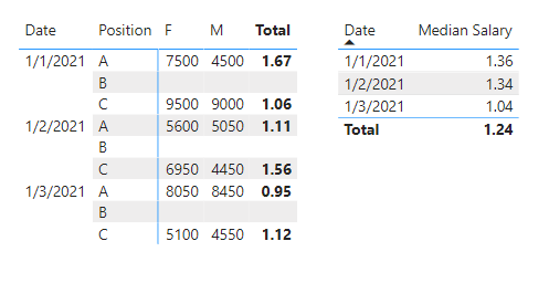

tamerj1
Hi @n00ne
One way to do that is by utilizing the column total to disply the F/M ratio.
Here is a sample file with the proposed solution https://we.tl/t-KF12DiUFOH
Median Salary =
VAR MedianSalary =
    MEDIAN ( Salaries[Salary] )
VAR M_FRation =
    AVERAGEX (
        SUMMARIZE ( Salaries, Salaries[Position], Salaries[Gender] ),
            DIVIDE (
                CALCULATE ( MEDIAN ( Salaries[Salary] ), Salaries[Gender] = "F" ),
                CALCULATE ( MEDIAN ( Salaries[Salary] ), Salaries[Gender] = "M" )
    IF (
        HASONEVALUE ( Salaries[Gender] ),
        FORMAT ( MedianSalary, "#" ),
        M_FRation
Hi @tamerj1 ,
The solution is great. Works perfect!
Just one question. Is the a way to adjust the formula to check if there are at least 2 occurances of each gender for respective position before calculating divide?
@n00ne
Can you clarify further perhaps using an example?
@tamerj1
Sure I can. Below you can find results for only first date
But of course same should apply to all dates. Basically in data we can see that for position B there is just one M in 1/1/2021 so that should not be taken into consideration. So the average is done only for 2 positions then for respective time.
Hi @n00ne
Code is updated as requested https://we.tl/t-kdg7GY1PmH

Hi @tamerj1 ,
Thank you for helping me last year with the query.
Now I have to amend it a little bit and it's tricky.
The result of the div should be multiply by number of employees (M+F) and divided by the number of all employees which pass the condition (kind of sumproduct). Graphic extension for the above table (columns are indexed for better visibility of calculations):
The result I need to achieve with the measue is the number 149%.
Please let me know if you are able to support me here.
Thank you very much in advance.
BR,
n00ne
