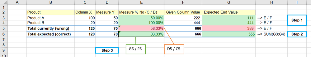

Unfortunately I've made a mistake in the definition and the final value should be different.
Let me try to explain the expected results:
  • Step 1: I want to calculate column G based on E and F on the most granular level
  • Step 2: For the total of column G (row 5) this calculation won't be right, so I need the sum.
  • Step 3: I want to calculate the total of column E, which can't be the same formula than the one on the most granular level (C divided by D) or the average (like in my original post), but I need to divide G6 by F6.
So I need two values which will be different on row level and on total level (G6 & E6) - I guess, there will be might be more than one calculation needed 🙂
Thank you and best regards
