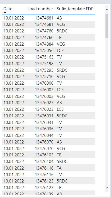

Hello, I 've been trying to solve this measure for a while. Every help is appreciated.
Data table has different values in Sufix template. Those values are connected with load number and I want to return a number of rows which include both values like A3 and VCG.
In case load number has both values then returned value shoul be 1.
I have tried many calculation but none return a correct value.
Here is last calulation i tried:

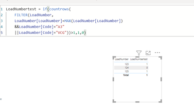

Here is one way to do this:
Data:
Dax:
LoadNumbertest = if(countrows(
FILTER(LoadNumber,
LoadNumber[LoadNumber]=MAX(LoadNumber[LoadNumber])
&&LoadNumber[Code]="A3"
||LoadNumber[Code]="VCG"))>1,1,0)
End result:
I hope this post helps to solve your issue and if it does consider accepting it as a solution and giving the post a thumbs up!
