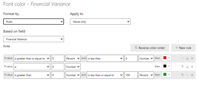

I have a measure with multiple Data formats Such as ( Number, Currency, and Percent) . I would like to setup conditional formating to show any value negative in Red and Any value >= 0 in Green.
However, at the bottom you can see that My First Number that is not Currency "0,00" and the Last one is Percent "0.00%" they stayed black . Is there any way to change those numbers  into Red  if they are Negative or Green if >=1 ?

My Conditional Formatting:
My result:

Hi, @NilR ;
I found the type of Financial Variance is text because here use FORMAT().
so if coniditonal format is rules, may be cause error. I think you could create other measure as Color based on a calculation.
Such as:
Measure = IF(CONTAINSSTRING([Financial Variance],"%"),"Green",IF([Financial Variance]=0,"Black","Red"))
The final output is shown below:

v-yalanwu-msft
Hi, @NilR ;
Such as:
https://docs.microsoft.com/en-us/power-bi/create-reports/desktop-conditional-table-formatting
Community Support Team _ Yalan Wu
