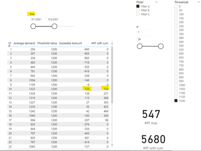

@ERD thanks for looking at this. It works when there aren't any date filters applied but not when some dates are selected in the report filter e.g.:
ERD
@DataNoobie ,
I've used a slicer for dates. But with filters it works the same way:

DataNoobie
@ERD How would I get the highest number from that #RT_Filtered column and a sum of the values from that column in two separate measures?
ERD
@DataNoobie ,
#RT with sum =
IF(HASONEVALUE(DummyDataID[ID]), [#RT_filtered], SUMX(VALUES(DummyDataID[ID]), [#RT_filtered]))
#RT max =
MAXX(
    ADDCOLUMNS(
        SUMMARIZE(DummyDataID, DummyDataID[ID]),
        "@RT", [#RT with sum]
    [#RT with sum]
If this post helps, then please consider Accept it as the solution ✔️to help the other members find it more quickly.
If this post helps, then please consider Accept it as the solution to help the other members find it more quickly. Appreciate your Kudos.
Check out my latest demo report in the data story gallery.
Stand with Ukraine!
Here are official ways you can support Ukraine financially (accounts with multiple currencies):
1) Support the Armed Forces of Ukraine: https://bank.gov.ua/ua/about/support-the-armed-forces
2) Come Back Alive foundation: https://www.comebackalive.in.ua/
Thank you!
Thank you - I can't thank you enough!

VAR RTAmt =
        SUMX( DummyDataDemand, [Exceeded Amount]),
        FILTER ( ALLSELECTED ( DummyDataID ), DummyDataID[ID] <= currentID )
RETURN RTAmt
#RT_filtered =
VAR currentID = SELECTEDVALUE ( DummyDataID[ID] )
VAR firstID = MINX ( ALLSELECTED ( DummyDataID ), DummyDataID[ID] )
VAR minValue = MINX ( FILTER ( DummyDataID, DummyDataID[ID] = firstID ), [Exceeded Amount] )
VAR RTAmt =
VAR minOfSum =
    MIN (
        0,
        MINX ( FILTER ( ALLSELECTED ( DummyDataID ), DummyDataID[ID] <= currentID ), [#RT] )
    IF (
        currentID = firstID && minValue < 0,
        RTAmt - minValue,
        RTAmt - minOfSum

Hello ERD !
Reading your post I though I would have solution I look for DAYS !! But I did try and get blocked...
I got nearly the same issue described in below linked, but adaptating your solution to my issue does not work. If you may have a few minutes to have a look I would be sooooooo gratful !
Cumulative-total-from-Matrix-column
Below is what I have tried - knowwing that Demand is a measure, taking Max (Forecast,OpenOrder), Forecast is a CAlculate from forecast table, OpenOrder is a calculate from Order Book table. Then I cannot do a SumX of Demand as Demand is not in one table.
Demand_Cumulative_Step1 =
VAR currentWeek = SELECTEDVALUE ( DateTable[WeeknYear] )
VAR RTAmt =
[Demand],
FILTER ( ALLSELECTED ( DateTable ), DateTable[WeeknYear] <= currentWeek )
RETURN RTAmt
Demand_Cumulative_Step2 =
VAR currentID = SELECTEDVALUE ( DateTable[WeeknYear] )
VAR firstID = MINX ( ALLSELECTED ( DateTable ), DateTable[WeeknYear] )
VAR minValue = MINX ( FILTER ( DateTable, DateTable[WeeknYear] = firstID ), [Demand] )
VAR RTAmt =
[Demand],
FILTER ( ALLSELECTED ( DateTable ), DateTable[WeeknYear] <= currentID )
VAR minOfSum =
MIN (
0,
MINX ( FILTER ( ALLSELECTED ( DateTable ), DateTable[WeeknYear] <= currentID ), [Demand_Cumulative_Step1] )
IF (
RTAmt - minValue,
RTAmt - minOfSum
Demand Step1 is not starting the good week and taked the max of cumulative forecast vs cumulative order, while I want to simply do cumulative of demand line
Demand Step2 is showing same Demand Step1 and even worse, adding multiple line for FAXTX data whichi is from another table, linked to Product.
Any Idea pelase ?
Thanks you so much !
