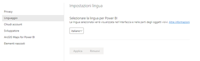

If I change the language to italian:
The products will change according the Service language:
