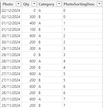

The only table on this job is this one:
Even worse, if I try to create a "descending sorting column" in my calendar table, the action of sorting the Date column by this new column is impossible as it creates a circular dependency.

Hello Ibdendlin,
You'll find the report right here.
The expected result would be as below in term of calculation: the delta D-1 is what is the difference between D0 and D-1 data (based on the snapshot date in column), but the sorting of the column values should be from the most recent to the oldest => first column displays 2024-12-02 data, second column 2024-12-01, etc.
see attached.
