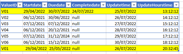

I'm having a problem with parsing when MAX(Duedate), I was taking into account that whenever there was a change in the deadline, it would be for the reason of extending the deadline. However, the deadline may be shortened.
I need a formula that returns the latest Duedate, so I can fit it into the Progress formulas. Kind like the image below.
In the case V01 would have to return, Duedate 07/25/2022, because the Updatetime and the time of the update is more recent, but I'm not sure how to do it using measurement.
