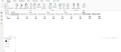

@Madhu155154create the two measures below, try them out, and let me know if there are any issues.
ahadkarimi_0-1723578584685.pngahadkarimi_1-1723578596265.pngahadkarimi_2-1723578606436.png
Filtered_Target =
VAR SelectedKPI = SELECTEDVALUE(Data[KPI Level], "L1")
CALCULATE(
    SUM(Data[Target]),
    Data[KPI Level] = SelectedKPI
Filtered_Actual =
CALCULATE(
    SUM(Data[Actual]),
