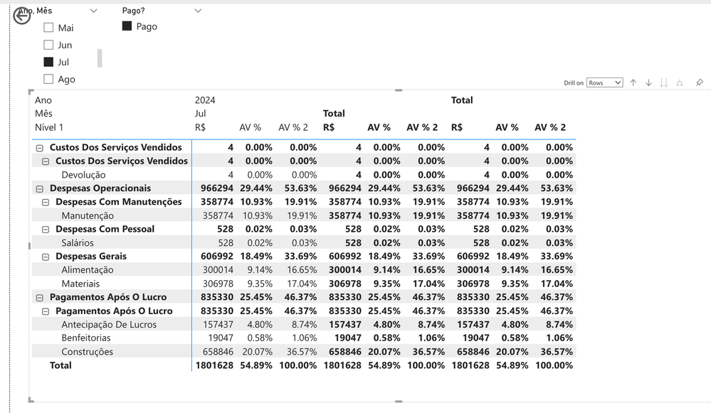

I have a pbix file with an example of a database. In it I have the categories in rows (3 levels) and the years and months in columns. As if it were an income statement.
Please help me with a vertical and horizontal analysis of the data in percentages.
I'm attaching the files and an image.

You sorted dDRE[Nivel 1] column with dDRE[Ordem], so if you want to remove filters on [Nivel 1] you need to remove filters on both [Nivel 1] and [Ordem] column.
If I understand your  expected results correctly then this is how you need to modify your measure
% Valor Orig Parc (n1n2c) V2 (PBI Community) =
Var __Numerator = [Valor Orig Parc]
Var __Denominator =
                    SWITCH(
                        TRUE(),
                          ISINSCOPE(dDRE[Categoria 1]),   CALCULATE([Valor Orig Parc],ALLSELECTED(dDRE[Categoria 1], dDRE[Nível 2], dDRE[Nível 1], dDRE[Ordem] ) ),
                          ISINSCOPE(dDRE[Nível 2]), CALCULATE([Valor Orig Parc],ALLSELECTED( dDRE[Nível 2], dDRE[Nível 1], dDRE[Ordem] ) ),
                          ISINSCOPE(dDRE[Nível 1]), CALCULATE([Valor Orig Parc],ALLSELECTED( dDRE[Nível 1], dDRE[Ordem] ) ),
RETURN DIVIDE(__Numerator, __Denominator)
This would be the result. My named the measure as [AV2] in the below matrix.
Please be informed I used  [Valor Orig Parc] measure in the denominator if you want to use [Valor Orig Parc Geral] then you can replace it in the demoinator variable. I am attaching the PBIX for your reference.
