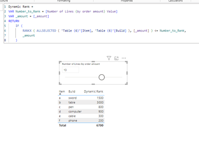

@Lefuneste57 - Just to clarify, my solution will work for you & it is dynamic (because it uses a measure), so the ranking will be re-calculated according to any filters you use on the page.
But you will need to use the measure below in any visual that you want to see this behaviour. There is no need to use a page filter because the measure handles the visual filtering. So if you want to filter an entire page, place the measure in every visual.
It works by only displaying the amount value when the rank number is lower than or equal to the number in the slicer. The slicer is created using these instructions: https://learn.microsoft.com/en-us/power-bi/transform-model/desktop-what-if
VAR Number_to_Rank = [Number of Lines (by order amount) Value] // from the numeric range parameter
VAR _amount = [_amount] // sum( amount )
    IF (
        RANKX ( ALLSELECTED ( 'Table (6)'[Item], 'Table (6)'[Build] ), [_amount] ) <= Number_to_Rank,
        _amount
    ) // Returns the amount for any items that with a rank within the numbers specified in the Numeric range parameter.

mark_endicott
@Lefuneste57 - Great! I'm so glad it's worked for you. Anything in a measure is Dynamic, so when you need things to change according to filters, you need a measure.

@Lefuneste57 - this would not be an issue in my solution becase the ranking would be dynamic.
The ranking that uses a column is static and therefore does not pay attention to filters.

I have suggested using a Measure and a What-If-Parameter (Numeric Range Parameter), because it is optimal and best practice. The measure can be used as a Visual Level filter, the slicer uses the parameter value to control the number of lines the measure shows.

@Lefuneste57 - You can do this with RANKX, and you will also need to create numeric range parameter.
Once you have created one of them, you can use the measure it creates as part of another measure that dynamically shows the amount, for the number of items you select. Below is my final measure, I will explain underneath:
    IF (
        _amount
The measure in Number_to_rank is from the numeric range parameter and presents whatever number is selected in the parameter.
The _amount measure is a sum of Amount
The RANKX gives the ranking by _amount for the two colomns in your table, which are inside the ALLSELECTED.
and the IF wrapper shows the amount for any rank that is less than or equal to the number from the Number_to_rank variable.

@Lefuneste57 - Sorry, I thought you may already be able to create a Numeric Range Parameter for the first part of my solution.
Here are the instructions, https://learn.microsoft.com/en-us/power-bi/transform-model/desktop-what-if, once you have followed these, you will get a measure in the new parameter table that you can reference in your Dynamic Rank measure.
In my solutuion, the measure that is auto generated by the parameter is
because I have named the parameter "Number of Lines (by order amount)"
