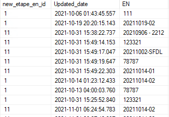

I ahve Table :
For each EN I want to calculate the difference of Updated_date for new_etape_en_id = 1 and 11 and obtain the overall sum of the difference.
Eg- for ([Updated_date] difference where [new_etape_en_id] = 1 and 11) for EN=111 + ([Updated_date] difference where [new_etape_en_id] = 1 and 11) for EN=20211019-02 + () +().....and so on.
How do I achieve the same?
Any help would be appreciated.
Thanks in advance

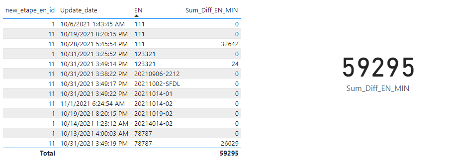

Hi @Anonymous
Please make some changes to Diff_EN_MIN measure as follows:
Diff_EN_MIN =
VAR max_ =
CALCULATE ( MAX ( 'Table'[Update_date] ), ALLEXCEPT ( 'Table', 'Table'[EN] ) )
VAR min_ =
MIN ( 'Table'[Update_date] ),
/*FILTER ( ALL ( 'Table' ), 'Table'[EN] = MAX( 'Table'[EN] ) )*/
ALLEXCEPT (
'Table',
'Table'[EN]
VAR minus =
IF (
SELECTEDVALUE ( 'Table'[Update_date] ) = max_,
DATEDIFF ( min_, max_, MINUTE ),
DATEDIFF ( MIN ( 'Table'[Update_date] ), MAX ( 'Table'[Update_date] ), MINUTE )
minus
And then create another measure with it.
Sum_Diff_EN_MIN = SUMX('Table',[Diff_EN_MIN])
Then use the new measure to create your visual, result will look like this:
Also, attached the pbix file as reference.
Community Support Team _ Caiyun
If this post helps, then please consider Accept it as the solution to help the other members find it more quickly. If you still have problems on it, please feel free to let us know. Thanks a lot!

Hey @v-cazheng-msft , Thanks for solution
If for the same EN , I have two records of new_etape_id =11 ,then I want to consider 11 which has greater updated date.
What changes can be made in the measure?!

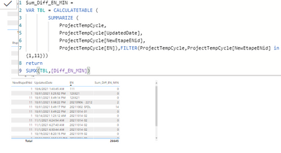

Thanks you for the help @v-cazheng-msft !
How do I create a summarized table containing only 1 and 11 in a measure if I have records in new_etape_id other than 1 and 11. I mean my table also contains new_etape_id values other than 1 and 11 but I want my ans only for 1 and 11 as done by you.
I wrote following query for it but didnt get correct ans
I just amended your Sum_diff_EN_Min measure. Rest all is same.
Please help.
