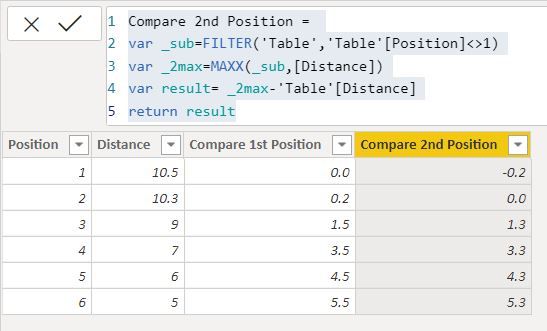

I have been trying to subtract values ​​from a table with a fixed measurement (first in the ranking, second, third ...), but I can't.
I would like to know if any of you can help me.

Create two calculated columns.
Compare 1st Position =
var _1max=MAX('Table'[Distance])
var result= _1max-'Table'[Distance]
return result
Compare 2nd Position =
var _sub=FILTER('Table','Table'[Position] = 2)
var _2max=MAXX(_sub,[Distance])
var result= _2max-'Table'[Distance]
return result

I appreciate your answer. I wanted to tell you that when I copied and pasted the DAX formula, I get an error in the penultimate line. Anotación 2020-05-09 123200.jpgDo you know why it could be?
On the other hand, I saw the two measurements, and they only differ from each other using MAX and MAXX. If I wanted to compare the value of the 6th position with the rest of the results, what should I change?
I appreciate your time and knowledge.
