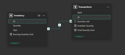

    Thank you for providing the sample data. It would have been beneficial to increase the number of rows in the "Transactions" table and include an expected outcome based that data. Nevertheless, I added additional data to the "Transactions" table to validate edge cases.
    The "Transaction" table I created is as follows:

    The relationship between the 2 tables are as follows:
