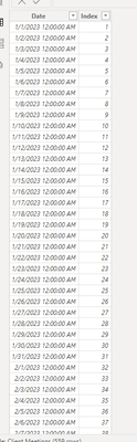

I have a DATESINPERIOD formula I am using to calculate a rolling 12-month average however it is not returning the correct result. I have 12 measure in total for which I am calculating current month, previous month and last twelve months rolling average. In each case the current month and previous month are calculating correctly and the rolling twelve month average is not.
Thanks for the reply from @foodd ,please allow me to provide another insight:
Hi, @Quenril
Regarding the issue you raised, my solution is as follows:
1.First I have created the following table and the column names and data are the data you have given:
2. Below are the measure I've created for your needs:
avrg =
VAR currrunt1 =
MAX ( 'time'[Date] )
DIVIDE (
DISTINCTCOUNT ( 'Client Meetings'[Index] ),
FILTER (
ALLSELECTED ( 'Client Meetings' ),
'Client Meetings'[Date] > EDATE ( currrunt1, -13 )
&& 'Client Meetings'[Date] < currrunt1
12
3.Here's my final result, which I hope meets your requirements.

Thank you so much Leroy - this is perfect. Exactly what I needed. Thank you so much for your help!
