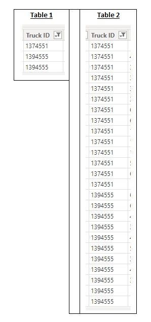

Hi - I have two tables where both tables contain a column with a unique ID number. Table 1 will contain a single or mutiple value of a unique ID number while table 2 will contain multiple values of the unique ID number. I would like to filter out all the unique ID numbers found in table 1 from table 2. How would I perform this step using a DAX command? Thank you.

Hi @rdstone230
Not sure what you are up to but you can try this filter
FILTER ( Table2, Table2[Truck ID] IN VALUES ( Table1[Truck ID] ) )
Hi @tamerj1
I am a novice analyst for a logistics company and I want to know how many of our trucks have delivered on time and to do so, I need to subrtact out trucks that have been rescheduled from trucks that have not. So my data is represented like this:
-Table 1 represents trucks that have been rescheduled for a variety of reasons. Each row of data represents a single truck that has been rescheduled. If two rows of the same Truck ID appears, then that truck has been rescheduled two times.
-Table 2 lists ALL and every truck and each row of the same Truck ID represents a single delivery point. If there are five rows of the same Truck ID then the truck has five different delivery points.
I want to subtract the Truck ID's in table 1 from those in table 2 so that I'm left with only the columns that represent Trucks minus Rescheduled Trucks.
BTW, I ran your solution and received the following error. I do have two columns in table 2 with the truck ID, but they aren't identical:
Thank you for your help with this!
Thank you @rdstone230
The information that you have provided is not sufficient to produce a concrete solution. I can understand the subtraction shall be curried out for each stop dependently. The data model/relationships must be clear, the data structure of each table must be clear and the nature of the report that clarifies the context of evaluation must be clear. I can suggest the following but I can also guess that probably it won't provide correct results within the evaluation context of your report.
CountMeasure =
COUNTROWS (
EXCEPT ( VALUES ( Table2[Truck ID] ), VALUES ( Table1[Truck ID] ) )
