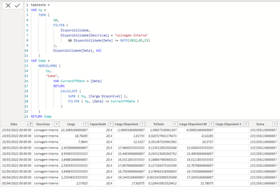

I'm trying to apply this to a column, but it's not returning the values i expected:
Seems like the [Data] =< EARLIER([Data]) filter is not working in this context of virtual table. Any tips on how to make it work?
Thanks in advance!

can you please explain what is the expected result?
Hi @Anonymous
you have nested iterators. I don't to which level of iteration you want to go back. But you can use EARLIEST to go back to the very first one. You can define inside EARLIER how many levels you need to go back. Alternatively you can store in a variable at the desired level.
I tried passing 2 as an argument of earlier, but it returns "EARLIER/EARLIEST refers to an earlier row context which doesn't exist."
I just wanted the sum of "Carga Disponível" where the date is equal or less than the one in the line context of the virtual table "tp"

Tthanks for exlpaining the context issue!
But i tried your code and it still returns the same results, unfortunatelly
Here's how it looks on the test table

That actually worked! Thank you!
