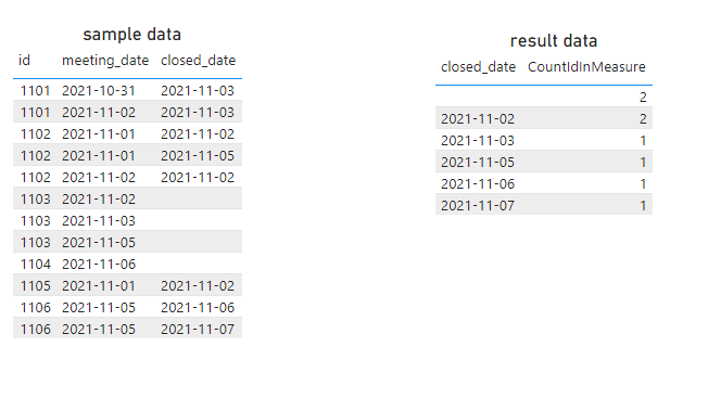

    Result will looks like this:
    Attached the pbix file as reference.

      Hey, thank you so much, you really helped me out! I appreciate it a lot.
