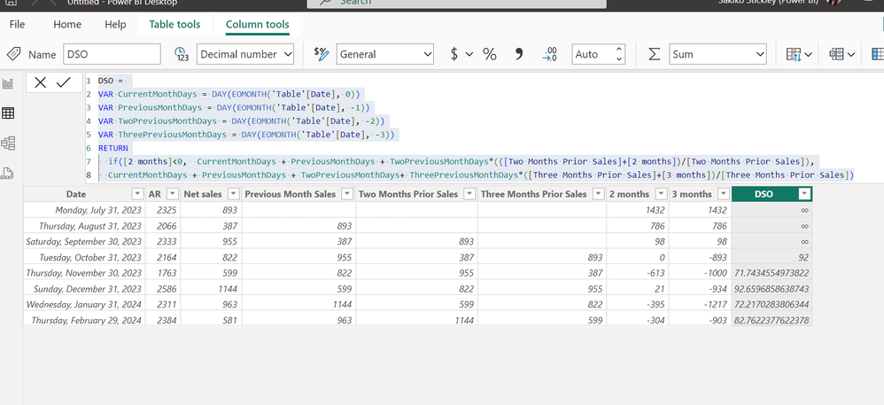

To check when the net composition of the current month's AR reaches zero or goes negative, you can create a calculated column like the one below:
2 months = [AR]-( [Net sales]+[Previous Month Sales]+[Two Months Prior Sales])
If the negative balance doesn't occur until the 3rd month, (i.e., the current month DSO is longer than 3 months),
3 months = [AR]-( [Net sales]+[Previous Month Sales]+[Two Months Prior Sales]+[Three Months Prior Sales])
You can then produce the countback DSO calculation in the following manner:
DSO =
VAR CurrentMonthDays = DAY(EOMONTH('Table'[Date], 0))
VAR PreviousMonthDays = DAY(EOMONTH('Table'[Date], -1))
VAR TwoPreviousMonthDays = DAY(EOMONTH('Table'[Date], -2))
VAR ThreePreviousMonthDays = DAY(EOMONTH('Table'[Date], -3))
if([2 months]<0, CurrentMonthDays + PreviousMonthDays + TwoPreviousMonthDays*(([Two Months Prior Sales]+[2 months])/[Two Months Prior Sales]),
CurrentMonthDays + PreviousMonthDays + TwoPreviousMonthDays+ ThreePreviousMonthDays*([Three Months Prior Sales]+[3 months])/[Three Months Prior Sales])
The resulting output is as shown below:
An important consideration in the relationship between Accounts Receivable (AR) and sales when calculating Days Sales Outstanding (DSO) is that, in some tax jurisdictions, output VAT is applicable. As a result, the AR balance includes VAT, while sales are recorded net of VAT. In these cases, it's necessary to either gross up the sales figure or net out the AR balance to ensure a proper comparison.
I have attached an example pbix file for your reference.
