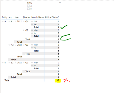

Can anyone help me on this scenario , which i am struggling for 2 days to arrive the solution,
> Fact table with Date,Entity, App, Value
>Need to identify the Value for the Entity & App combination for maximum date
>This will dynamically aggragted based on the multiple date hierarchy filters (screenshot attached)
>In the grand total i should see the sum of individual aggration (by summarizing Entity, app, value from above (respective date hierarchy)
I have tried to get the 505 of the result using below measure, but finding challenges in the grand total.
Critical_Status2 =
VAR X=SUMX (
    GROUPBY (
        FILTER ( 'Sample', 'Sample'[Date] = MAX ( 'Sample'[Date] ) ),
        'Sample'[Entity],
        'Sample'[app],
        "CRT", SUMX ( CURRENTGROUP (), 'Sample'[Critical] )
    [CRT]
if(HASONEVALUE('Sample'[Entity]),X,SUMX (ALLSELECTED('Sample'),X))
Hi @tomsmith213 ,
You can create another new measure as below and put this new measure to replace the original measure [Critical_Status2] onto the table visual. Later check if it can return the correct total values...
New Measure =
SUMX (
    GROUPBY ( 'Sample', 'Sample'[Entity], 'Sample'[app] ),
    SUMX (
        GROUPBY (
            'Calendar',
            'Calendar'[Year],
            'Calendar'[Quarter],
            'Calendar'[Month_Name]
        [Critical_Status2]
