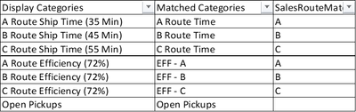

I have 2 slicers is my projects which are both shows here in the left corner. When I select a Visual Category, I would like the cooresponding Sales by the related Route code. Example, I click on "A Route Time" and the line in the graph only shows A routes. I select "C Route Efficiency (72%)" and i see only sales for C Routes. Now if i select "Open Pickups", I was to see a sum of all sales (A,B,C, Blank, etc). Would anyone be able to show me the proper DAX functions and structure?
[Visual Category} is my table for my slicer
Here is a sample [Sales] table that has direct relationship to the table above based on Route. Some route letters will not match example D, E or U. Some will be blank.
