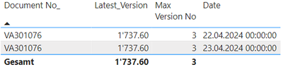

Problem:
I believe that the DAX Formula is not quite correct.
In the table it shows me the amount twice, but in the total it only shows one amount.
The assumption is that there are duplicate values in the bar chart.
Does someone have an idea how to adjust the DAX Formula?

@Greg_Deckler thank you for the links and information.
Would it be possible for you to adjust the DAX formula with your instructions?
@bedata1 Well, I would think something like:
Latest_Version Total =
VAR __GT = SUMX( SUMMARIZE( 'Sales Line Archive', [Document No_], "__Value", [Latest_Version] ), [__Value] )
VAR __Result = IF( HASONEVALUE( 'Sales Line Archive'[Document No_] ), [Latest_Version], __GT )
__Result
@Greg_Deckler Thank you Greg, that works.
The only problem I still have is that I have two different dates and so it shows the total on both dates.
How can I add the MAX Date to the DAX formula so that I only get one line?
Hi @Greg_Deckler ,thanks for the quick reply, I'll add further.
Hi @bedata1 ,
I've assumed some data that you can modify based on the DAX expression I provided.
Measure =
VAR _a = CALCULATE( MAX('Table'[Date]),ALLEXCEPT('Table','Table'[Type]))
VAR _b = MAXX(SUMMARIZE('Table',[Type],"Amount",MAX('Table'[Amount])),[Amount])
RETURN IF( SELECTEDVALUE('Table'[Date]) <> _a,BLANK(),_b)
