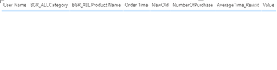

Q2-1: I think I have found the core of the problem. I was creating columns instead of measures before (why is that so?). Now that I used measures with the formulars that you kindly provided, it almost perfectly works. There is just a small hick up, which I'd like to understand/circumvent.
Issue1:
The table now shows the correct values! Thank you at that stage already.
However, if I include the exact dates for which Emil purchased something, the average time between purchases disappears. Is there a way to keep the variable visible in the table for each day?
Issue2:
Also, I can not use the measure in a visualization really. Since it, as you described, always calculates a difference between two values, I can not depict the average repurchase time in a KPI card, in a gauge or in a bar chart - which was the goal. Would you know how to adjust that I would be able to display that?
Similarly, when displaying in a table, I would want to show the average time between purchases of categories/products excluding the users - so averaging on total category level. How would that work?
Best regards and many thanks!
@Jannnn04 Hi, Jannnn04
1. I was creating columns instead of measures before (why is that so?).
Calculate column evaluates each expression under row context. and filter context does not exist in calculate column.
COUNTROWS function, like SUM( ) or AVERAGE( ), conducts it's calculation under Filter context. since there is no filter context in calculate column, it calculates over entire table. that's why you got total number.
But measure is different. both CALCULATE and CALCULATETALBE invoke Context Transition which means, these two function change Row context to Filter context (in other words, context transition makes the 1 row as it's filter). one important thing is that all measures are wrapped by CALCULATE function inside the engine regardless you used calculate function for your measure or not. Therefore, if you create a measure, it will colcuate for the current row only.
Having say that, to create a column with the same result, you can simply wap the expression with CALCULATE as below.
Measure: NumberOfPurchase = countrows(All_Platforms)
Calculated column: NumberOfPurchase = CALCULATE(countrows(All_Platforms))
1. Average time with specific time:
As I expalined previously, to calculate average time, you need at lease two transactions because the average time is the Time Gap between 2 transactions.
If you want to show the earler time and the average time in the same row in the report, you need to create a table for it.
2. I can not depict the average repurchase time in a KPI card, in a gauge or in a bar chart
The measure (average time) needs customer as it's filter context because we cannot define re-purchase without "WHO" but the gauge does not have customer filter unless you select specific "customer" from outter filter. (e.g. selecting "Emil" with slicer).
If you want to show overall "avg. revisiting time" regardless customer (which means average of revisiting time for all customers who purchased item at least twice), then it will be another measure which can be combined with eailer one (the indivisual average time).
In that case, the 2 measures can be combined as below:
IF indivisual is selected, return the value from eailer measure,
else return value from new measure.
(By the way, those customer who purchase only once shoule be excluded for the new measure.)
I hope you can handle your issues with above guideline. I may make the code when I find time but not sure when.
so If you are looking for the solution urgently, please find help from others.
Thanks.
