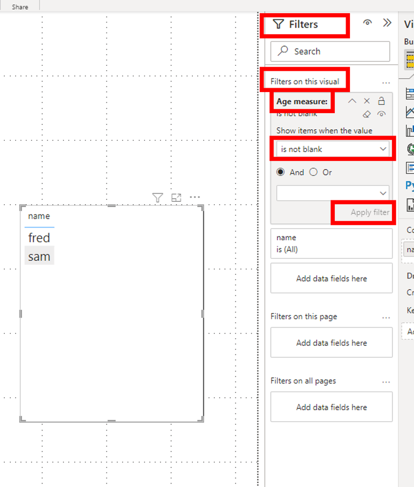

    • Jihwan_Kim's avatar
      Jihwan_Kim
      Thank you for your feedback.
      Please check the below picture and the attached pbix file.
      One of ways to achieve this is using "Filters on this visual" feature in Filters section.
      - Select a visualization that shows all names.
      - Go to Filters section and drag the measure (Age measure:) into the Fiters on this visual area.
      - select "is not blank" from the dropdown.
      - click Apply filter.
