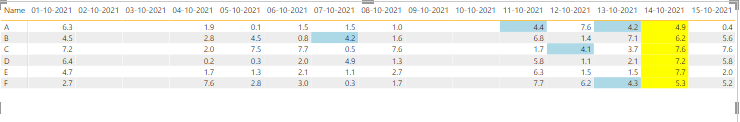

Conditional formatting using dax
I want Grey backgroung color where the matrix values are blank.
For that I wrote following measure but I am not getting desired output.
format= SWITCH(True(),SELECTEDVALUE('Employee Data'[Date])=TODAY(),"Yellow",SELECTEDVALUE('Employee Data'[Actual Hours])<4.5 && SELECTEDVALUE('Employee Data'[Actual Hours])>=4,"LightBlue",SELECTEDVALUE('Employee Data'[Actual Hours])=BLANK(),"Grey")
Matrix:
Can someone help!!
@Anonymous Actually matrix visual not consider blank value for conditional formating when we use Format by as field value . So we need to do one work around.
1. Update your Actual date column code with below code:-
Actual Hours =
VAR result =
    IF ( WEEKDAY ( 'Employee Data'[Date], 2 ) <= 5, 'Employee Data'[Hours Worked] )
    IF ( result = BLANK (), 0, result )
2. Update your conditional formatting code with below code:-
Conditional Formatting =
IF(
    "#E7F508",
    IF(
        "#08BCF5",
        IF(
            SELECTEDVALUE('Employee Data'[Actual Hours]) = 0,
        "#859CA4"
You will see below output:-

Hey @Samarth_18
I tried that code but its not working for blank values!!

This one is also not working!!
Is it possible for you to share PBIX file after removing confidential data?
Actual Hours =
VAR result =
IF(
    "#E7F508",
    IF(
        "#08BCF5",
        IF(
        "#859CA4"
