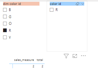

I am having a problem with understanding what filter function should I use in my example:
I have some simple model with fact table and 2 dimensions with attributes and 2 measures where:
sales_measure=SUM('fact'[sales])
total=CALCULATE([sales_measure],ALL('fact'[color id]))
So I am using ALL('fact'[color id]) to clear filter contex from this column which is also key column in relationship with color dimension.
Now I would like to use a slicers from color dimension but when I am using it is not working as I want and my total measure is affected by this slicer  - in my understanding it shouldn't because 'dim'[color id] affecting 'fact'[color id] (relationship) and on this column I have ALL function applied to clear all filters on that column.
Then, when I am using color id column from fact table for slicer, it is working fine:
My conclusion is that ALL(column) function is not able to clear filters that are coming by relations. However I noticed that ALL(table) function is able to clear all context even from relations.
But I can't just simply use this ALL function on a table because in my real project I have much more slicers that are coming from different tables and I don't want to clear the context from them by apllying ALL on my whole fact. I just want to clear the context from my one column (that is key column to dimension), but I want this column to be cleared also when I am using fields from this dimension as a slicers.
I know that If I want to slice data by fields from dimensions I could use then ALL(column from dimension) function, but the hardest thing here is that I have to use only fields from fact to clear the context from this one dimension.
Any thoughts or useful functions here? 🙂

Hi @Anonymous ,
For the difference between ALL(column) and ALL(table), you can check this blog:
Managing “all” functions in DAX: ALL, ALLSELECTED, ALLNOBLANKROW, ALLEXCEPT - SQLBI.
Then in your scenario, try this:
total =
    [sales_measure],
    TREATAS ( ALL ( 'fact'[color id] ), 'Dim'[Dim color id] ),
Here's my test example:
Reference: TREATAS function - DAX | Microsoft Docs

That is not what I was asking.
The question is how can I clear the filter context in fact table that is coming from one dimension, by using field from a fact table. ALL(fact) is working here but it is clearing as well the rest of filter context from other dimenstions that I would like to keep.
