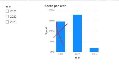

My problem is pretty simple. I have a date Slicer (Year, Month & Day) and a Chart showing sales with Date as an axis.
I would like to show only rolling 12 months data on my sales measure when the slicer contains no selection.
The expected result is the following
And when no date is selected, show sales only for 02-2022 to 02-2023
Is it possible to performs this without having to add an independent date slicer ?
Thanks for your help

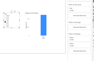

For an entirely measure approach try something like this:
(Filter measure)
Measure 44 =
IF(ISFILTERED('Calendar'[Year]),
1,
IF(
    MAX('Calendar'[Date]) in DATESBETWEEN('Calendar'[Date], TODAY()-365, TODAY()),1,0)
Base measure:
Measure 45 = SUM('Table (28)'[Value])
Place filter measure into filter pane like this:
With filter:
You might need to play around with the dimensions to get the visual you want, but filter measure would be the most logical approach if you don't want new slicers or tables
(Filter measure)
Measure 44 =
1,
IF(
Base measure:
With filter:
