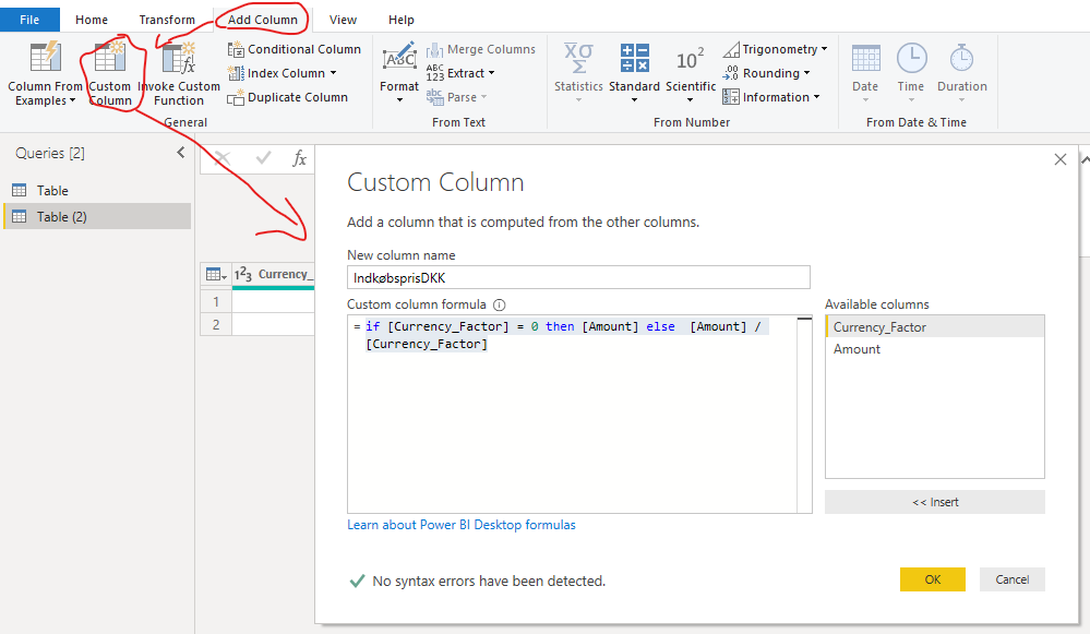

Hi All
I have an issue where i in the same collum have differnt types of amounts and in different currency. But i need to calculate it to DKK for them all. i have an factor for other than DKK, thats set to 0.
I made this command - that works in Qlickview - but need something that works in PowerBi
IndkøbsprisDKK = if (Currency_Factor = 0 ; (Amount))
IndkøbsprisDKK = if (Currency_Factor < 0 ; (Amount / Currency_Factor))
IndkøbsprisDKK = if (Currency_Factor > 0 ; (Amount / Currency_Factor))
this is my dato and how it looks:
Anyone that can help me?

You can go to Add Column, then Custom Column and type the following:
if [Currency_Factor] = 0 then [Amount] else  [Amount] / [Currency_Factor]
