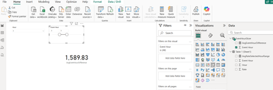

NG1407
Its not giving correct result. Its giving same value for all customers.

Hi @NG1407 ,
Here are the steps that should help you with your task ^_^:
1. Create a Measure for Hours:
First, you'll need to create a measure for the average rate within a specific hour range. Here's the formula for that:
AvgRateSelectedHourRange =
VAR SelectedHour = SELECTEDVALUE('Table 1 (Sheet1)'[Hour])
VAR HourRange =
    FILTER(
        ALL('Table 1 (Sheet1)'),
        'Table 1 (Sheet1)'[Hour] >= SelectedHour - 1 &&
        'Table 1 (Sheet1)'[Hour] <= SelectedHour + 1
    AVERAGEX(HourRange, 'Table 1 (Sheet1)'[Rate])
2. Create a Disconnected Table for Event Hours:
You will need to create a disconnected table that represents your event hours. This will allow for better control over filtering without affecting other data in your model.
3.Create a Measure for Calculating Differences Using the Event Hours Table:
AvgEventHourDifference =
VAR AvgRate = [AvgRateSelectedHourRange]
VAR SelectedEventHourStart = MINX(ALLSELECTED('EventHourSlicer'[Event Hour]), 'EventHourSlicer'[Event Hour])
VAR SelectedEventHourEnd = MAXX(ALLSELECTED('EventHourSlicer'[Event Hour]), 'EventHourSlicer'[Event Hour])
VAR EventHourDifferences =
    FILTER(
        'Table 1 (Sheet1)'[Event Hour] >= SelectedEventHourStart &&
        'Table 1 (Sheet1)'[Event Hour] <= SelectedEventHourEnd
VAR AverageDifference =
    AVERAGEX(
        EventHourDifferences,
        ABS(AvgRate - 'Table 1 (Sheet1)'[Rate])
    AverageDifference
4.Add Visuals for the Event Hour Slicer:
Finally, use the disconnected table to add visuals for the event hour slicer. This will allow you to filter the data based on your selected event hours and display the corresponding results.
Hope it helps!
