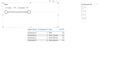

I've expanded the logic to my uncleansed data and it worked as intended. I then decided to add FTE data and that highlighted a scenario I hadn't included in my initial request which wasn't calculating as intended.
I have some employees which have a change in FTE values but stay in the same role. In these cases the employees return a 0 in the measure and don't appear before the latest role change and then sum both the FTE values after the latest role change. I can get the FTE to calculate correctly with a measure once it appears but I can't figure out how to modify the measure from the previous solution so they appear before the latest role.
So the updated table would look like this:
(Only difference from previous post is that employee B now retains the same 'Role' but moves to 0.6 FTE )
In this case I get.
After May:
Before May:
Like mentioned above, I can fix the FTE count after May, just not sure how to get an employee to appear before May without ruining the logic for the rest of table.

Hi @Oberon ,
My Sample:
I have a test on myside, I suggest you to try code as below to create a FTE measure directly.
M_FTE =
VAR _RangeStart =
    MIN ( 'Date'[Date] )
VAR _RangeEnd =
    MAX ( 'Date'[Date] )
VAR _Filter1 =
    FILTER (
        ALLSELECTED ( EmploymentHistory ),
        EmploymentHistory[Date] <= _RangeEnd
            && OR (
                EmploymentHistory[End Date] >= _RangeStart,
                EmploymentHistory[End Date] = BLANK ()
VAR _Filter2 =
    FILTER (
        _Filter1,
        VAR _EMID = [Employee ID]
        VAR _MAXDATE =
            MAXX ( FILTER ( _Filter1, [Employee ID] = _EMID ), [Date] )
        VAR _Role =
            MAXX ( FILTER ( _Filter1, [Employee ID] = _EMID && [Date] = _MAXDATE ), [Role] )
            [Role] = _Role
    SUMX (
        FILTER (
            _Filter2,
            [Employee ID] = MAX ( EmploymentHistory[Employee ID] )
                && [Role] = MAX ( EmploymentHistory[Role] )
        [FTE]
Result is as below.
After May:
Before May:

Thank you Rico Zhou, this works well.
If anyone else is looking to run a similar scenario as me and is struggling to finish the last bit where it sums both the part and full time FTE values on the month where the change occurs I added the following to Rico's solution.
Created a calculated column:
FT/PT = if([FTE]=1,"FT","PT")
Then another 2 measures:
MeasureFTPT =
LASTNONBLANK(EmploymentHistory[FT/PT],maxx(EmploymentHistory,EmploymentHistory[Employee ID]))
and
M_FTE2 =
if(
    and([MeasureFTPT] = "PT",[M_FTE] > 1),
    [M_FTE]-1,
    if(
        and([MeasureFTPT] = "FT",[M_FTE] > 1),
        1,
        [M_FTE]
Then just use M_FTE2 in place of FTE in the table columns and everything should work.
