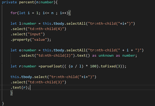

I am creating a custom visual as below,
In the input column i give some numbers and it calculates the percantage as Totalsalescost/Input
But in percentage column the result gets reflected  only when i increase or decrease the size of table created.How can i solve this so that percentage column gets  reflected as soon as i enter input value
This is the snippet I used
Please help me with this

@dm-p
As i have attached the screenshot of custom visual table in first post which i created i am getting default value for column percentage as infinite.can you please check with this as value should be zero or empty and then based on input it should change.
below is the snippet I used to add cell value to each row
        let rows = this.tbody.selectAll("tr")
            .data(viewModel.dataPoints)
            .enter()
            .append("tr")
            .attr("id"id + 1);
let id2number = 0;
        let cells = rows.selectAll("td")
            .data(function (row) {
                return columns.map(function (column) {
                    return {
                        column: column,
                        value: row[column]
            .enter()
            .append("td")
            .attr("id"id2 + 1)
            .style("text-align""center")
            .style("vertical-align""middle")
            .text(function (di) {
                return d.value;

Thank you for the reply I have found the problem was with percentage calculation.
Yup - I just saw your original post in my email feed and figured it would be a divide by zero issue. Glad you're sorted 🙂
On how to ask a technical question, if you really want an answer (courtesy of SQLBI)

Thank you for the respose @dm-p
I am creating text box as below how can i add event to this.
My table is getting reflected only when i resize it.
